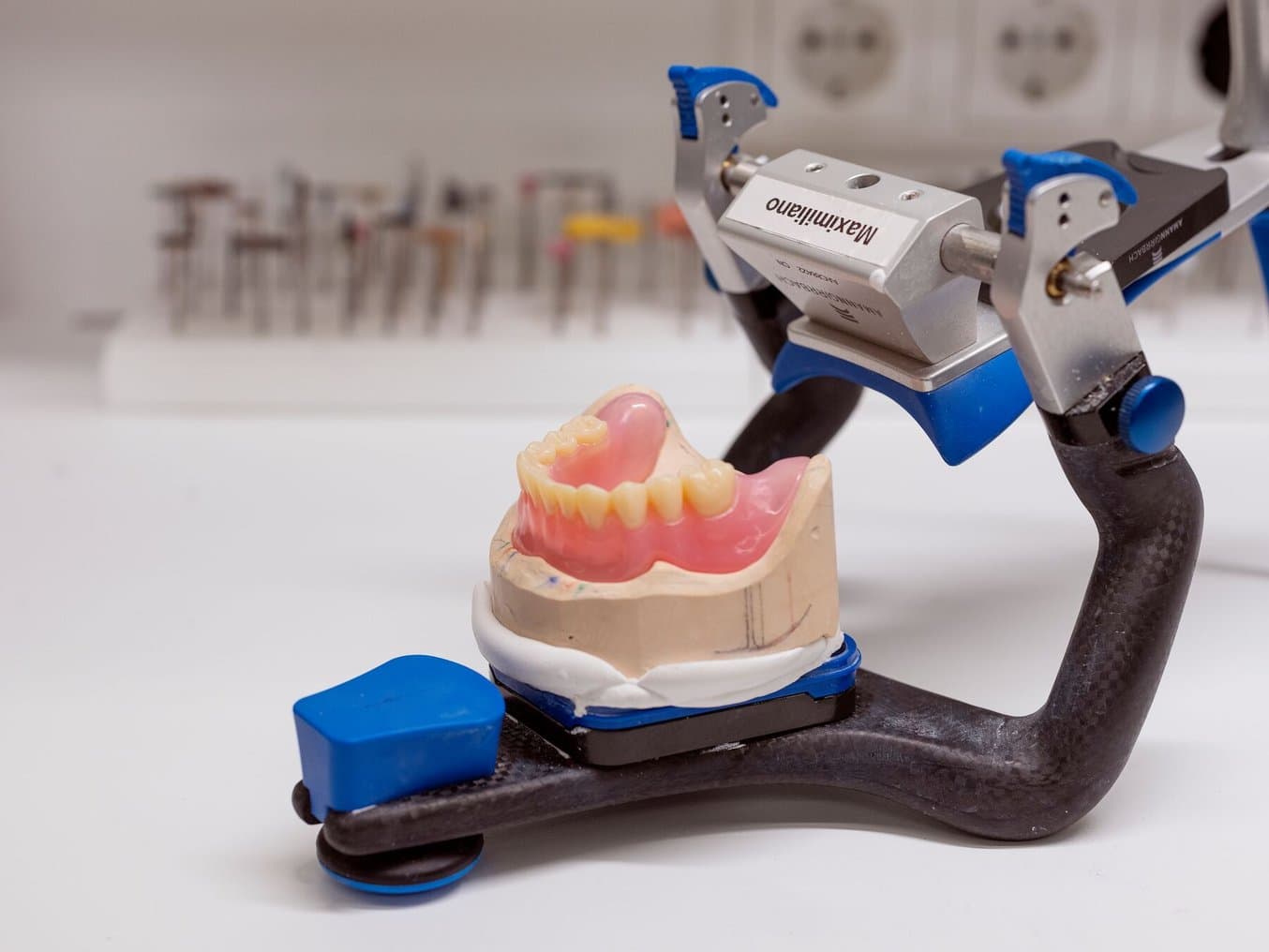

A finished mandibular denture printed in Denture Base Resin and Denture Teeth Resin.

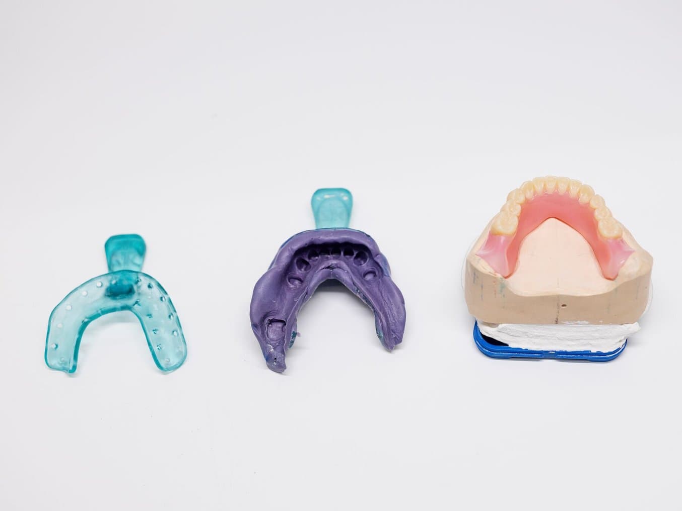

The digital denture workflow begins with capturing an intraoral scan. "Our dentists are doing a lot of intraoral scanning. About 80% of impressions are sent to us digitally," Guendler reports. Based on these scans, custom impression trays are digitally designed and then 3D printed. The custom trays can then be used to take a further, traditional impression of the patient's dentition, as full dentures usually require an additional mucodynamic impression. This way, muscle attachments can be taken into consideration when printing the denture base. The new impression is then digitalized.
The workflow for producing digital dentures, from custom impression trays printed in Custom Tray Resin for taking traditional impressions, to a finished mandibular denture.

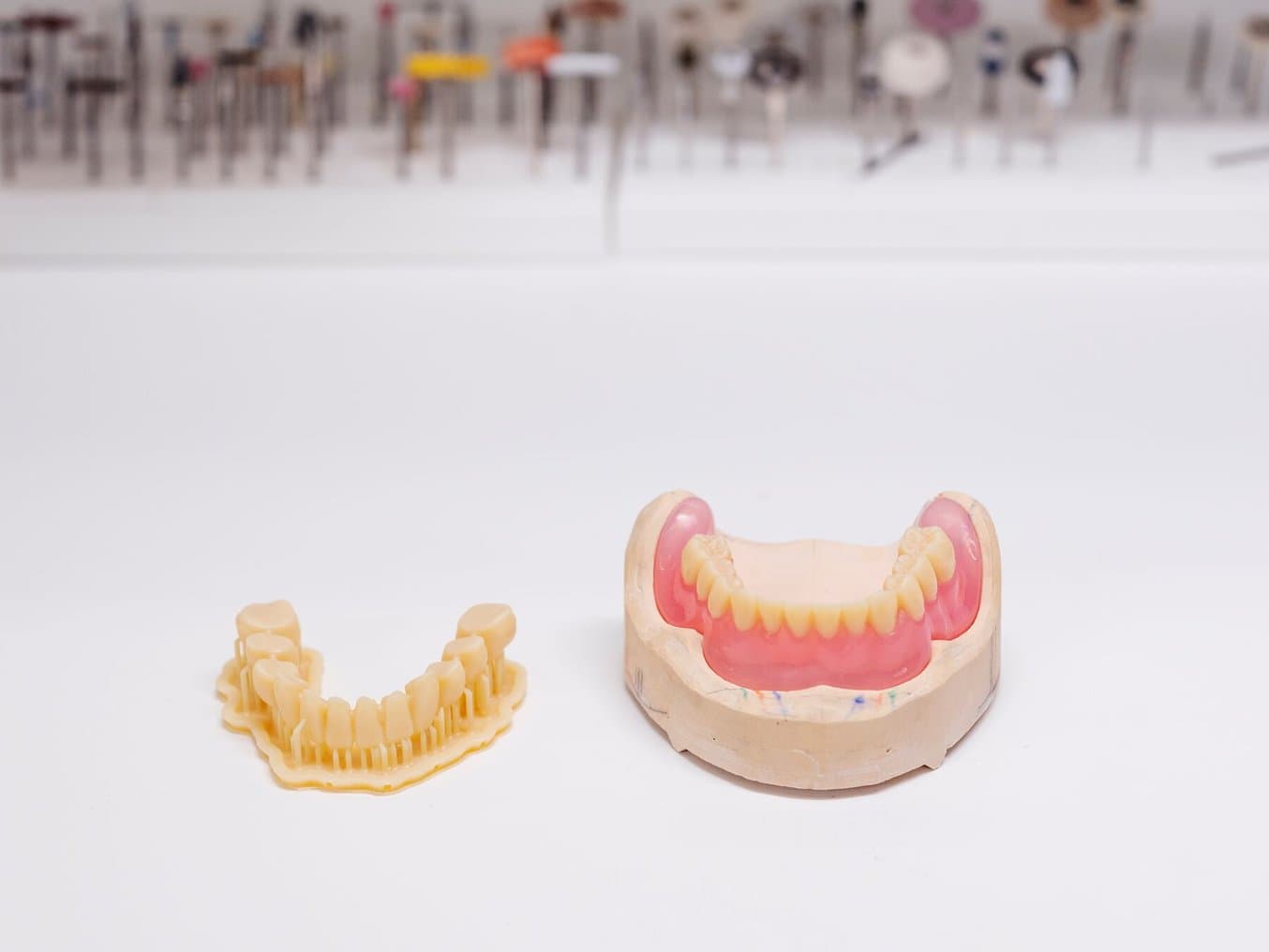

Left: 3D printed denture teeth made from Denture Teeth Resin. Right: 3D printed full mandibular denture made from Denture Base Resin and Denture Teeth Resin.

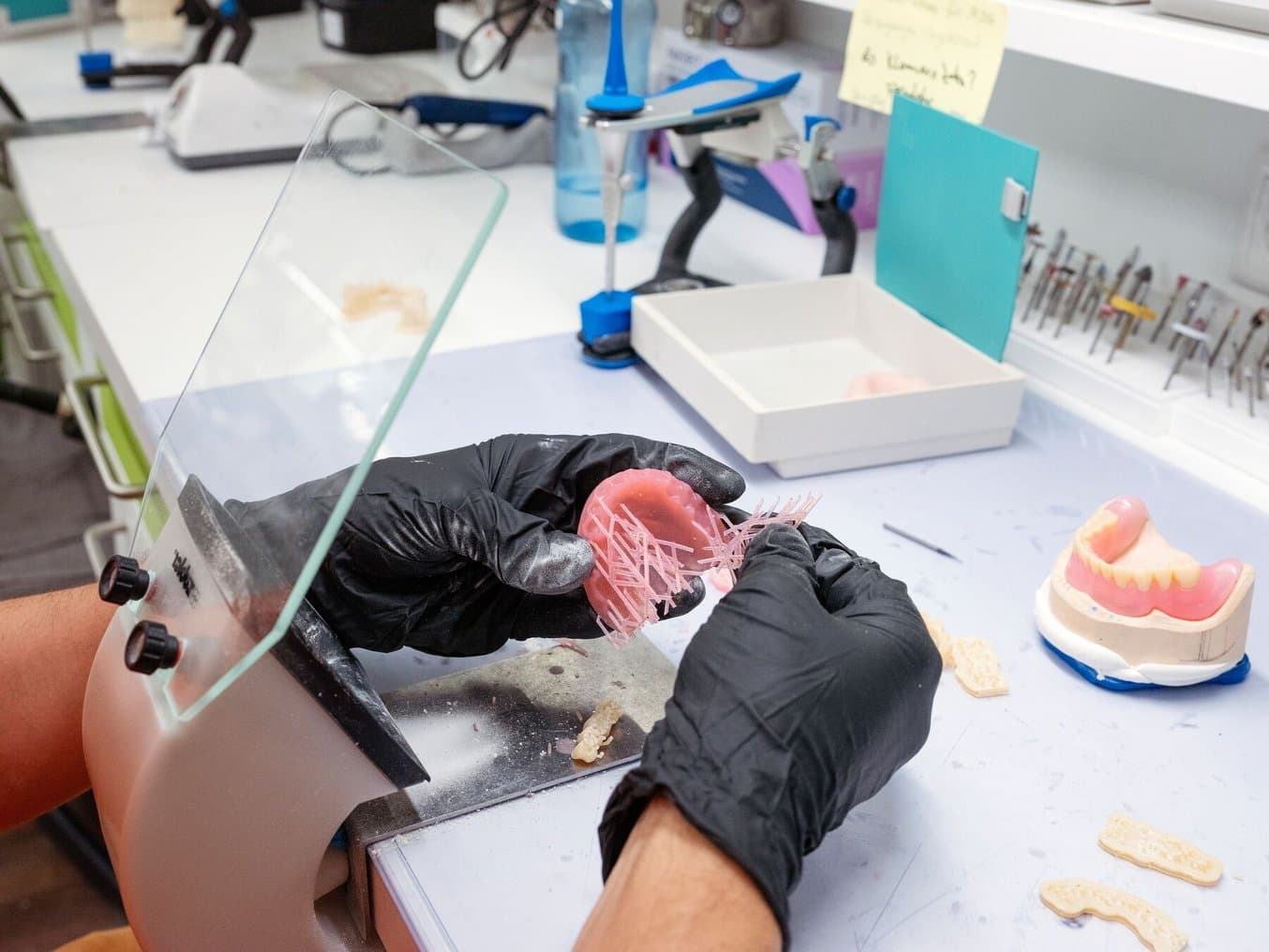

Guendler also highlights the health benefits that he experiences with digital workflows compared to his years of using traditional manufacturing methods. "The digital manufacturing of dentures I think has the big advantage that us dental technicians hardly come into contact with the material. I used to have skin contact with various harmful plastics, monomers, and polymers on a daily basis and was breathing in their hazardous fumes." Having to work with wax and fire are further unpleasant elements of traditional workflows. By designing dentures on the computer and 3D printing, comparatively minimal post-processing is required, meaning dental technicians can benefit from a cleaner, safer, and more pleasant workflow.
Easy removal of support structures from a denture base printed in Denture Base Resin.
