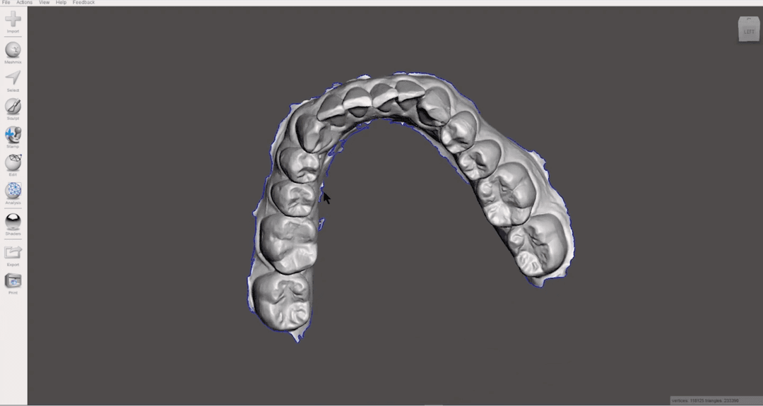

Digital teeth models segmented from CT images.
![](/_next/image/?url=https%3A%2F%2Fdental-media.formlabs.com%2Ffiler_public_thumbnails%2Ffiler_public%2F6f%2F51%2F6f51bd96-1e64-48ed-bcff-de9f97f425ba%2Fimage3.jpg__1354x0_q85_subsampling-2.jpg&w=2048&q=75)
While considering creative solutions to the problem of providing hands-on training remotely, Dr. Uslu reached out to Formlabs reseller Btech to see if 3D printing could solve her problem. After receiving the request from the professor, the Btech Dental and Medical team used Materialise’s medical image analysis software, Mimics Innovation Suite, and computed tomography (CT) images with a slice thickness of 0.5 mm taken from the head and neck region of a patient. Using Mimics, they isolated individual teeth, including roots, made adjustments, and exported each model as a 3D file.
