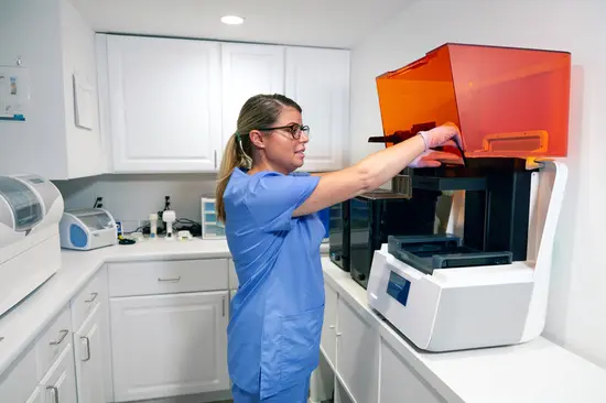

3.4 Start Print
Shake the resin cartridge and then insert the cartridge, a build platform, and a compatible resin tank into the Formlabs 3D printer.
Note: Please verify printer and resin compatibility on the Formlabs support site before printing.
