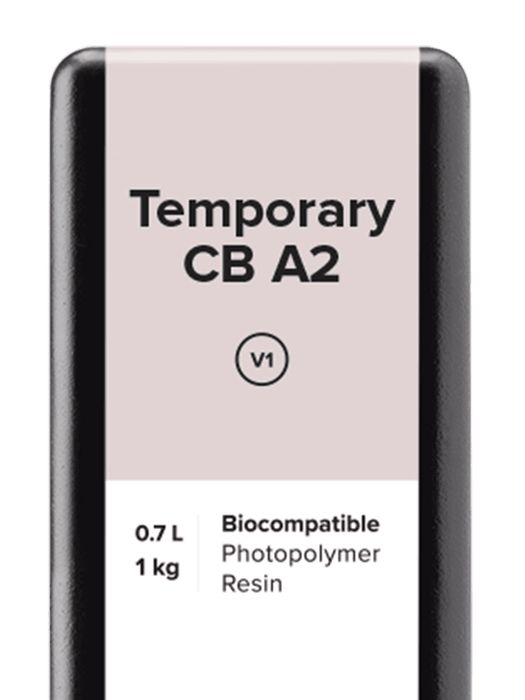

Temporary CB Resin is used to produce precisely fitting temporaries with a smooth surface finish, high resolution, and dimensional stability. This starter pack includes the required Stainless Steel Build Platform as well as the a cartridge of Temporary CB Resin to get you printing right away.
