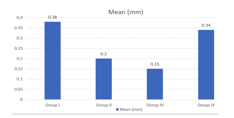

Impression quality can vary a lot. “Accuracy of different materials used in impressions for fixed partial dentures” by Dr. Farhat Jabeen, Dr. Pratibha Sharma, and Dr. Paritosh Sharma [8] indicates that the accuracy of traditional impressions will offer a mean trueness of 0.25 mm (averaging different impression materials where polyether is the most precise and condensation silicone the least). Hence, comparing the accuracy of dental models produced with traditional techniques and with additive manufacturing needs to take into account the workflow and success rate of each method.
Graph showing the mean deviation of different impression materials

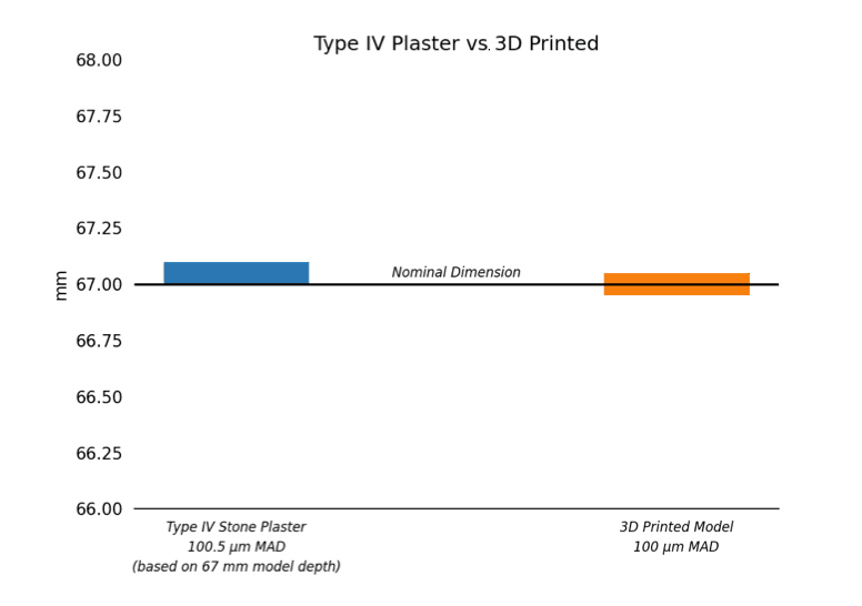

A Specific Example for a Type IV Stone Plaster Model
Let’s take, for instance, a dental arch with a sagittal depth of 67 mm, derived from the average length of several dental arches. For a plaster model meeting the Type IV criteria, the maximum permissible deviation (which, in this case, is exclusively positive) would be calculated as follows:
  • Model Size: 67 mm
  • Acceptable Linear Expansion: 0.15%
  • Tolerance Range: 67 mm × 0.15% / 100 = 0.1005 mm
For the plaster model, the MAD is computed thus:
  • Minimum Deviation (at 67 mm): |67 - 67| = 0 mm
  • Maximum Deviation (at 67.1 mm): |67.1 - 67| = 0.1 mm
  • MAD = (0 + 0.1) / 2 = 0.05 mm
Assessing the Accuracy of a 3D Printed Resin Model
Assuming a 3D printed model exhibits a similar range of deviation but in both directions, we would expect a similar MAD if the model is equally accurate. For a deviation range of ±0.05 mm (67 mm ±0.05 mm):
  • Minimum Deviation (at 66.95 mm): |66.95 - 67| = 0.05 mm
  • Maximum Deviation (at 67.05 mm): |67.05 - 67| = 0.05 mm
  • MAD = (0.05 + 0.05) / 2 = 0.05 mm
When considering the accuracy of 3D printed models, it’s interesting to note how this is framed at Formlabs. Accuracy is typically described in terms of “X% of the model’s surface being within a range of ±Y mm of the nominal object.” Applying this to the previous example, it would mean that “100% of the surface of the printed model falls within ±0.05 mm (50 µm) of the nominal dimension.” This approach, while simplified, offers a practical and informative way to gauge and contrast the precision of various manufacturing techniques used in creating dental models.
However, translating a norm based on maximum linear expansion, such as the one used for plaster models, to the realm of 3D printing, isn’t straightforward. It involves establishing a comparative metric that takes into account the inherent limitations and characteristics of 3D printing technology. This comparison seeks to bridge the gap between different manufacturing processes, providing a common ground to evaluate their accuracy, while acknowledging that each method has its unique attributes and constraints.
Chart comparing Type IV plaster models versus 3D printed ones
