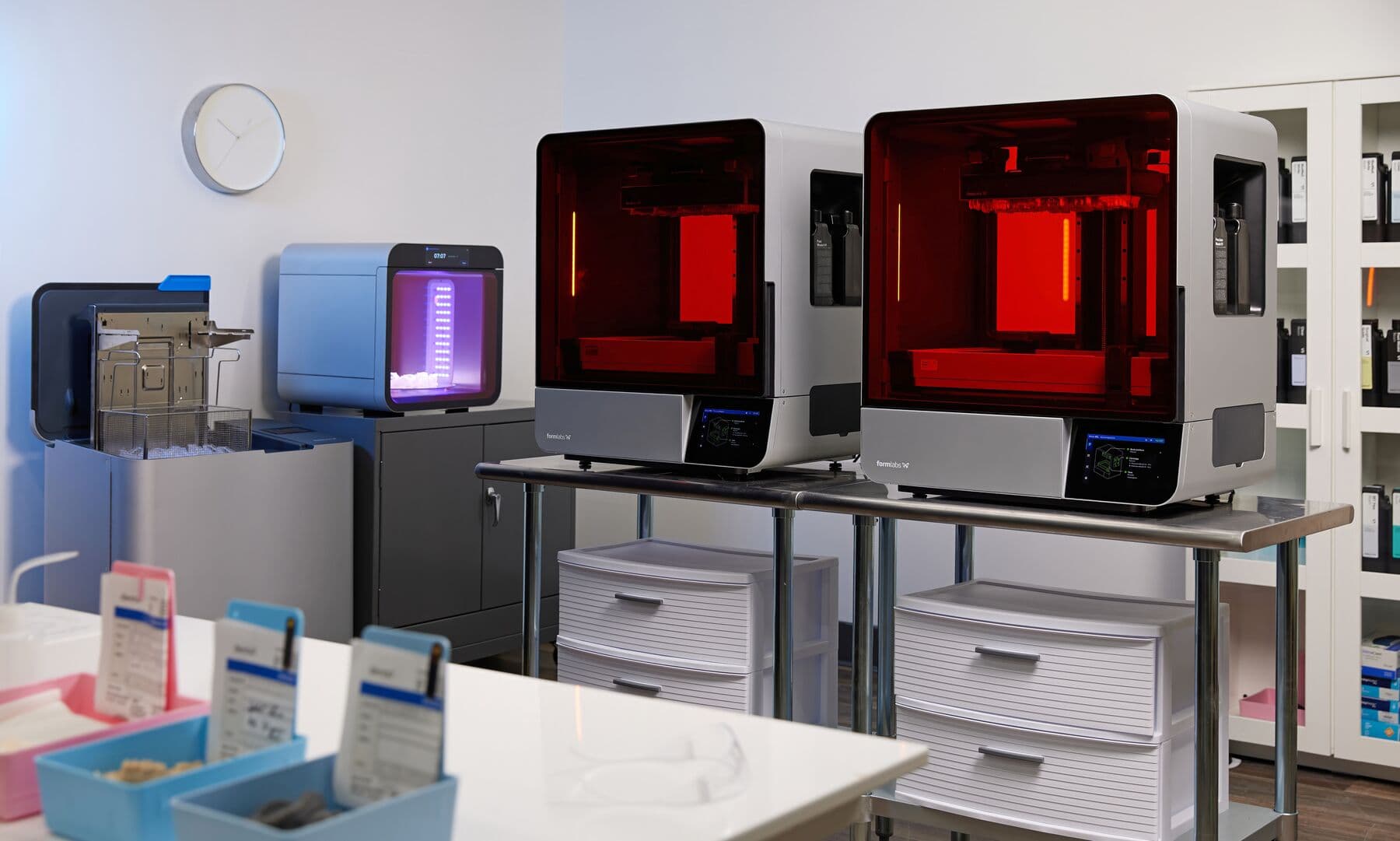

Looking at Form 4BL, by contrast: one Form 4BL is roughly 20% of the cost of the yearly lease for a Carbon L1 — and the Form 4BL is then owned outright. This makes purchasing an extra printer more accessible. In a scenario with an extra printer or safety unit, if a critical failure occurs on one printer, it can be replaced by the extra printer in under 15 minutes. In this scenario, only 15 minutes of production time are lost before production returns to 100% availability.
Maximizing availability can be achieved by minimizing downtime. One way to mitigate downtime is with a fleet of printers. For example, in a legacy industrial system, unplanned downtime could be a single sensor failure. While this is happening, availability is 0%, and production is completely halted. If a manufacturer was instead using a fleet of printers and this occurred for one printer, the other printers would continue printing, making for a slight drop in availability rather than a hard stop.

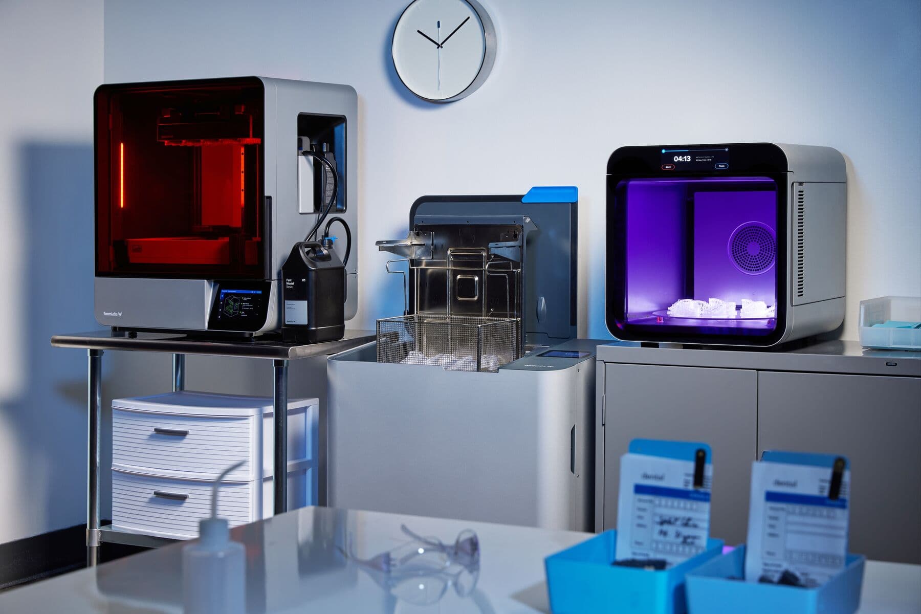

Form 4BL with Resin Pumping System, Form Wash L, and Form Cure L
Resin Pumping System delivers 5 L of resin to the printer, minimizing cartridge changes. Additionally, resin consumption can be tracked on Dashboard for accurate material usage planning.

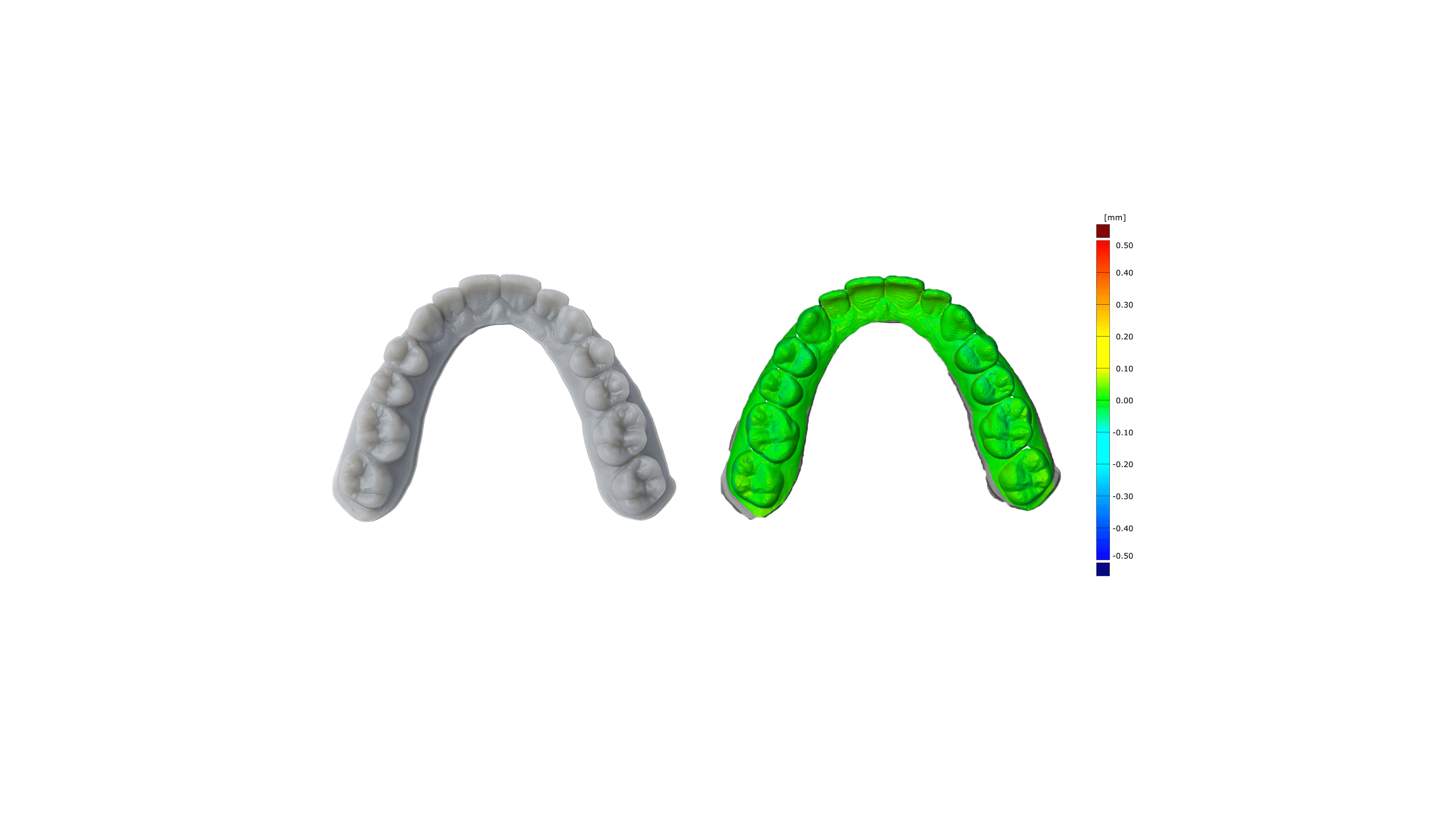

Heat map of accuracy of restorative models
Restorative models printed in Precision Model Resin at 50 μm on Form 4BL have 95% of the surface within 50 μm of the CAD model and 99% of the surface within 100 μm.
Heat map accuracy of a model for thermoforming
Models printed at 160 μm in Fast Model Resin on Form 4BL have 95% of the surface within 100 μm of the CAD model.
