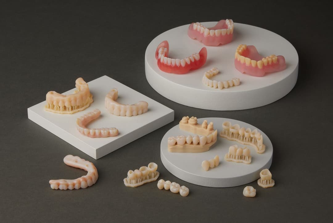

Dr. Lanoiselée uses Formlabs 3D printers and dental materials to print models, direct composite restoration guides, surgical guides, provisional crowns, long-lasting temporary restorations such as bridges, permanent restorations for inlays, temporary and permanent dentures, and splints.
