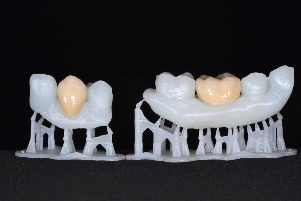

First, we take impressions of a patient’s mouth and create plaster models. We then create a digital scan of the model, and use software to plan the modifications we’ll make in surgery. To test our results, we print our new design on the Form 1+ 3D printer, fit it on the plaster model, and make a template over the printed design and model.
We send the diagnostic and template to the dentist who then will explain the treatment plan to the patient and demonstrate how the treatment will work in the patient’s mouth. This gives us a huge advantage as the patient knows exactly what to expect.
How were you doing this previously?
The models had to be obtained from alginate impressions and cast in plaster. Previously, the diagnostic designs were waxed by hand; it was very time consuming. Before the Form 1+, you had to use commercial printers, and that makes the models very expensive. Now I am able to make high resolution 3D printed teeth models in-house for a fraction of the price.
How long does it take you do to each print? How do you get the model?
It takes between 2-2.5 hours to do a print at 0.05. We design our models on 3Shape CAD–which is specifically designed for dental purposes.
