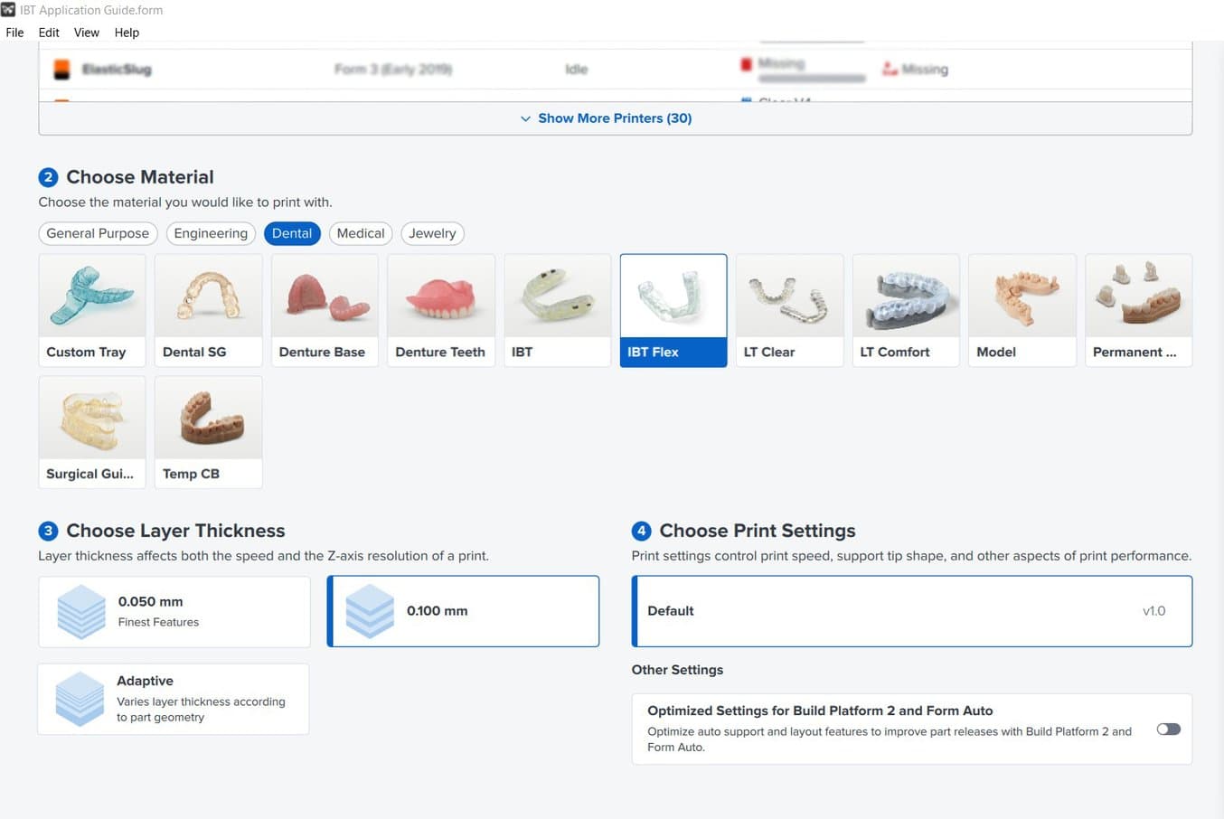

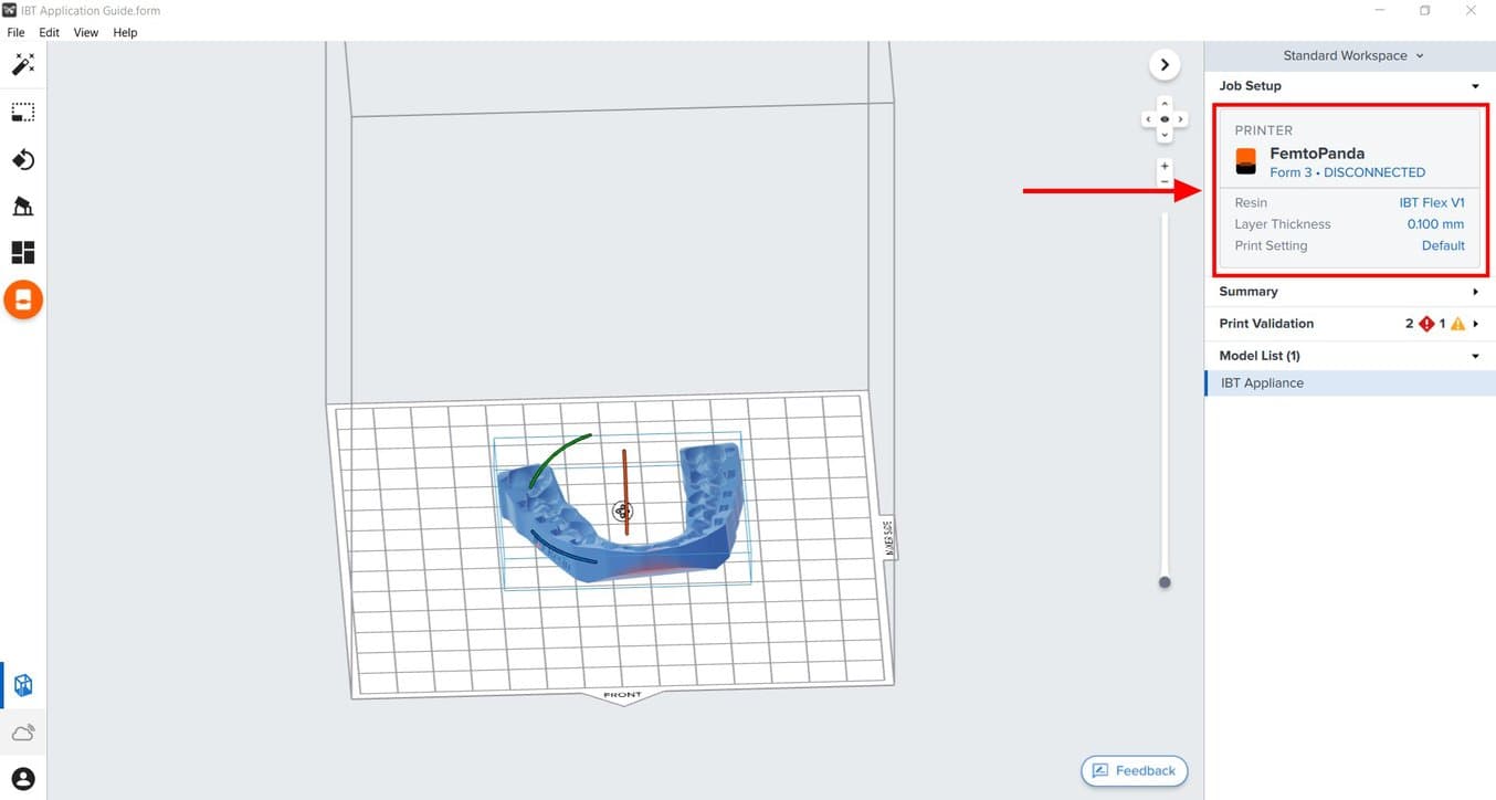

4.1  Material and Layer Height Selection
  1. In the Job Setup menu on the right side, click the printer box to select your printing material.
  2. Do not use a predefined Preset (1), as PreForm does not offer one for IBT Flex bonding trays.
  3. Select your printer (2). Under Choose Material, select IBT Flex Resin (3) and the desired layer thickness.
  4. For IBT Flex bonding trays, 0.1 mm layer thickness (4) works well. You may choose 0.05 mm for finer details.
  5. Click Apply (5) to finalize your job setup.
material and layer height selection

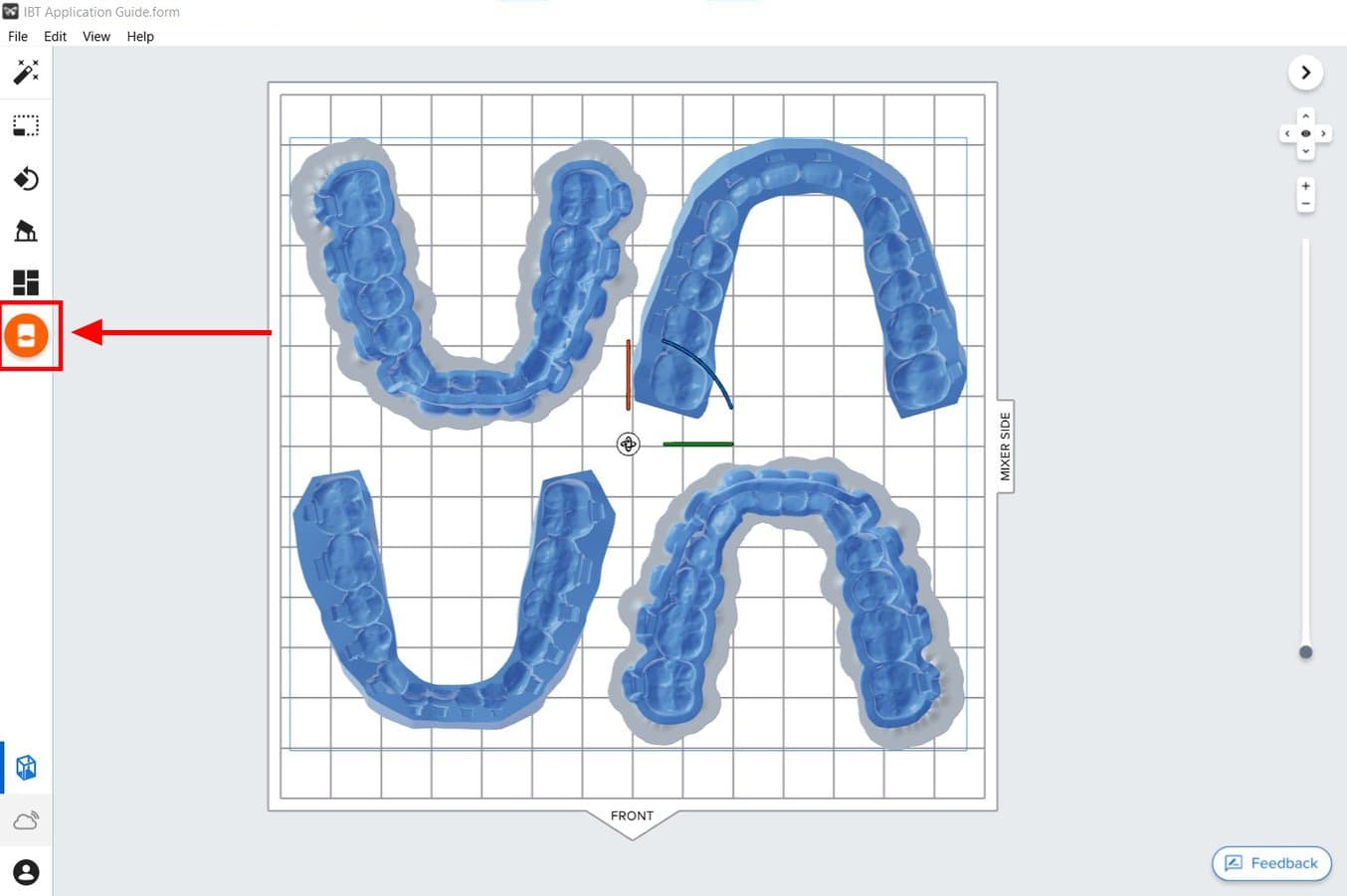

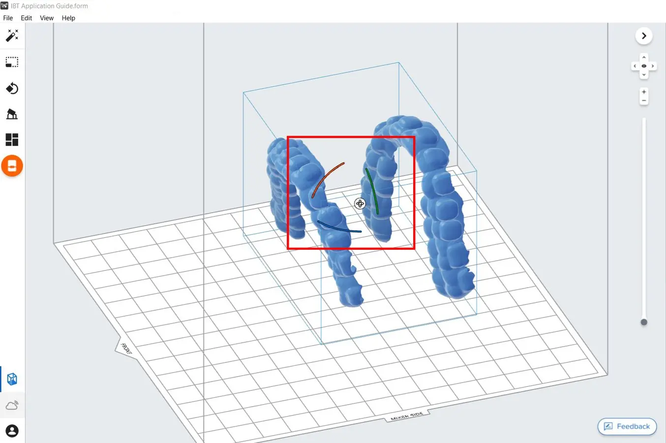

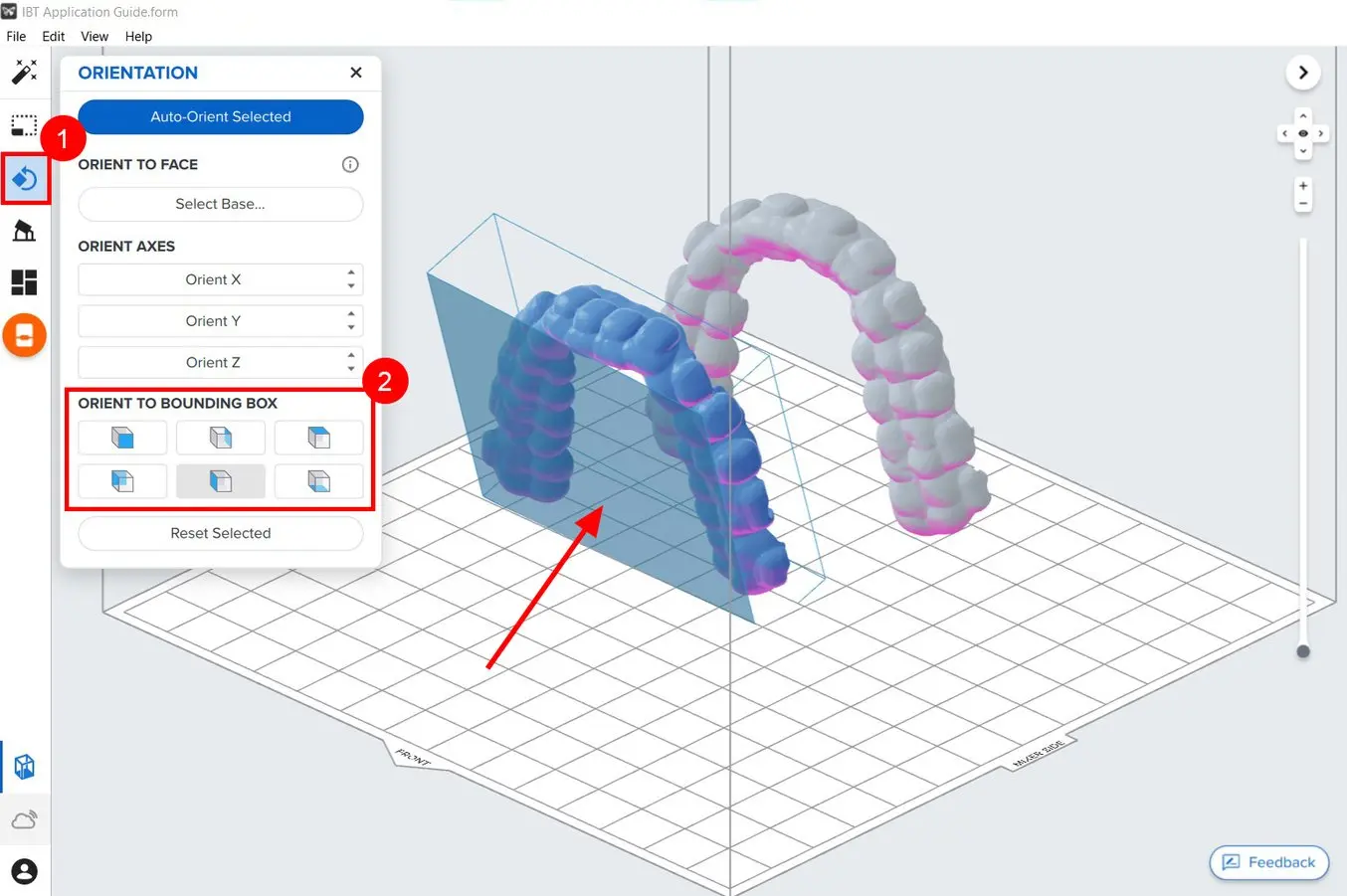

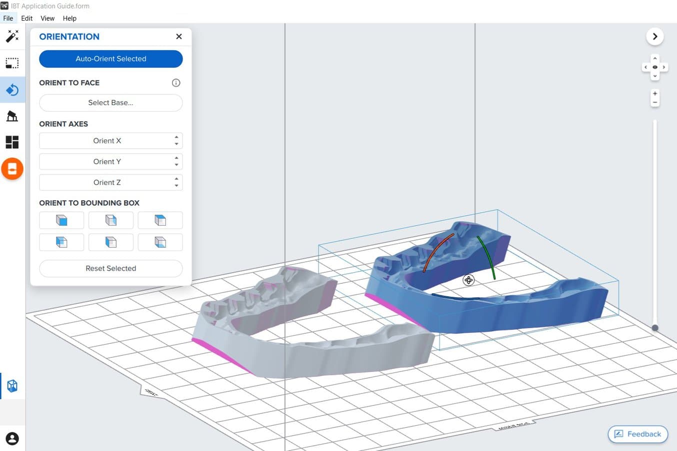

4.2 Orientation
For appliances designed with the bar-type design, the bottom surface can be adhered directly to the build platform.
Note:

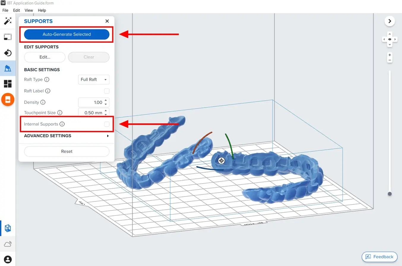

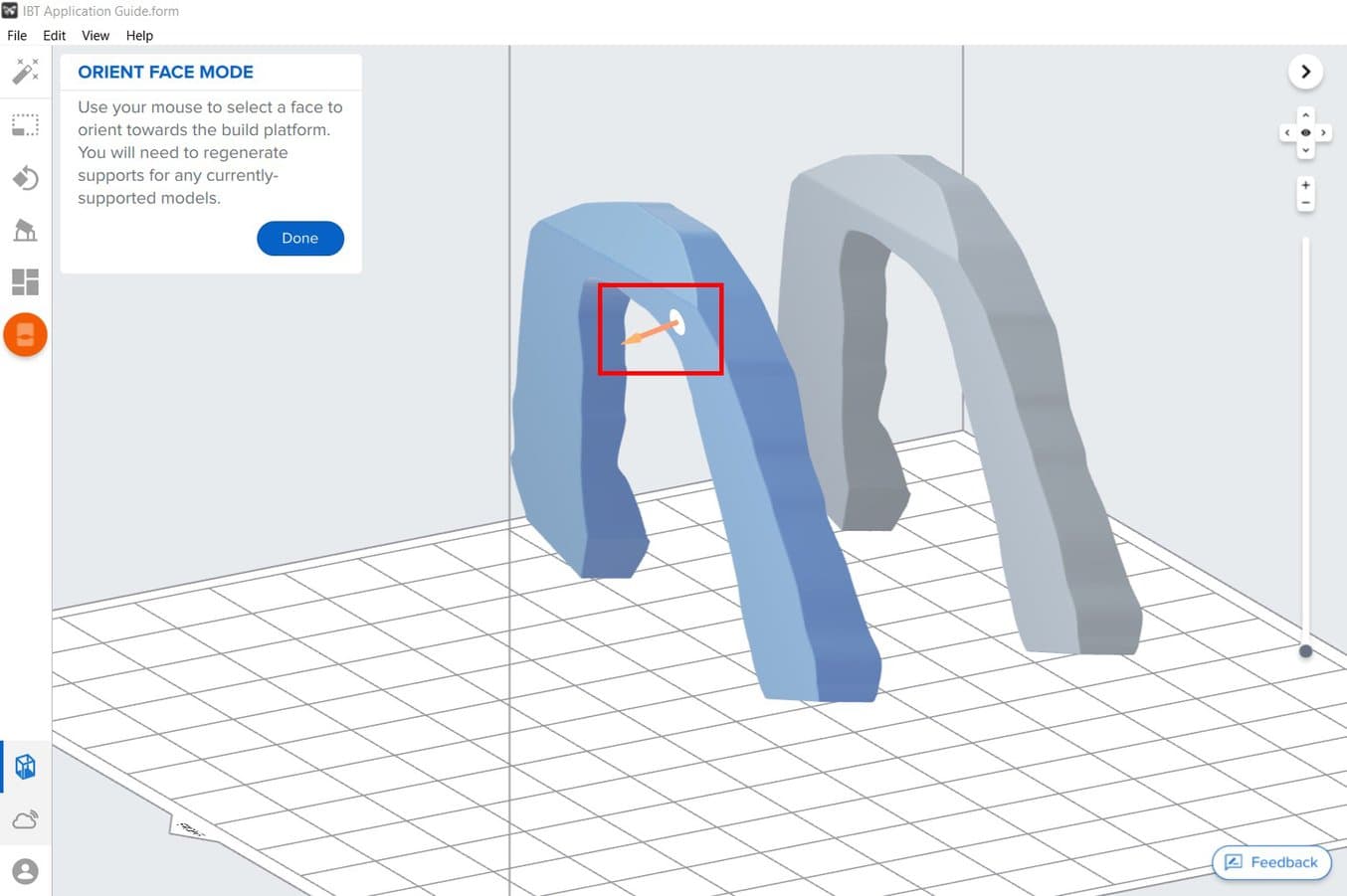

Offset-type bonding trays need to be placed on supports. In this case, try to align your tray parallel to the build plate or at an angle below 40°. Please refer to this playlist on our YouTube channel to learn how to add supports to your model.
Open the Orientation tool (1) and click the Select Base (2) button.
dental model orientation
Next, click the bottom surface (3) of the part to adhere it to the build platform and confirm by clicking Done (4).
If you need to print multiple trays, add them all to your job. Ensure they are placed on the build plate without overlapping. The Layout All tool under PreForm's Layout menu can simplify this arrangement process.
Note:
If you are using supports for your bonding trays, you may overlap the support rafts if you leave space between the trays themselves.

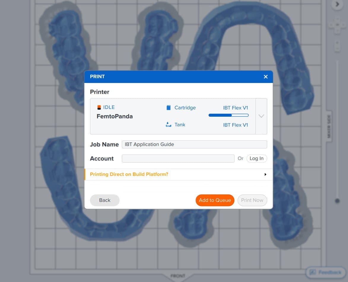

4.3 Transferring the Job to the Printer
Once the layout is complete, the job is ready to send to the printer. Send the job to the printer by clicking Print Now. If your printer is not ready to print, the button will change to Upload to Queue, and will start printing once you have prepared your printer.
preform job to printer

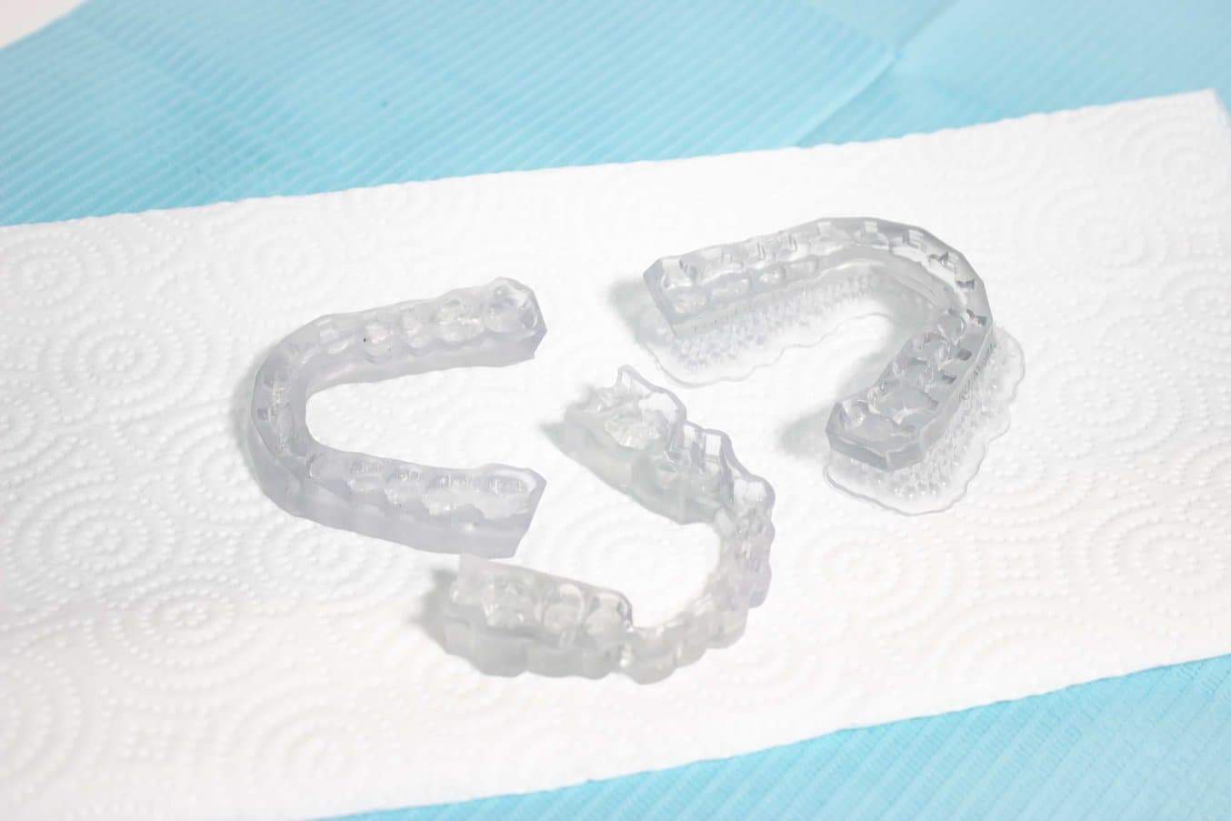

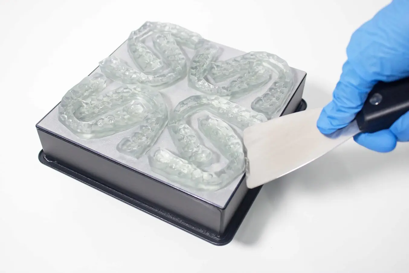

5.1 Part Removal

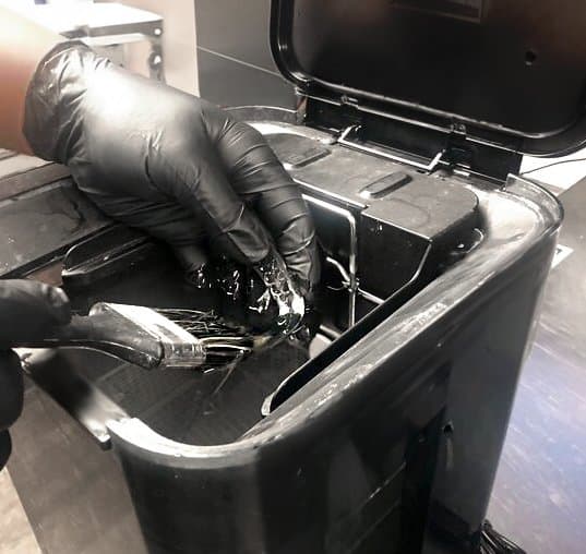

Remove printed parts from the build platform by wedging the Part Removal tool or a spatula under the part and rotating the tool.
Note:
Due to the flexibility of parts printed with IBT Flex Resin, they might not be released as easily as other, more rigid materials when using the Flex Build Platform.

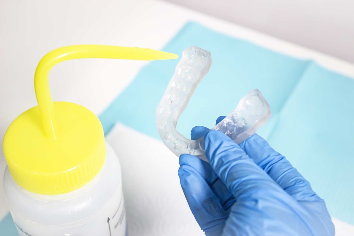

5.2 Washing
Precautions:
  • When washing the printed part with solvent, ensure a properly ventilated environment and use protective masks and gloves.
  • Expired or unused IBT Flex Resin shall be disposed of in accordance with local regulations.

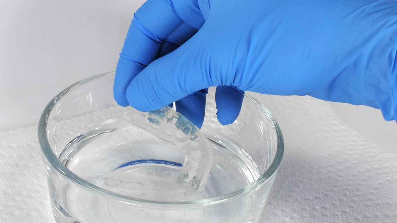

Place printed parts in a Form Wash or Form Wash L filled with isopropyl alcohol (IPA, ≥99%) and wash them for the time established in the Manufacturing Guide.
Make sure the parts are fully submerged in IPA when washing.
If your part geometry traps residual resin, it may be beneficial to lightly swish a paintbrush back and forth along the bracket pockets midway through the wash cycle.
Exceeding wash duration may affect dimensional accuracy and performance of printed parts over time.
Watch this video to learn how to properly wash your IBT Flex Resin bonding tray.
5.3 Drying
Remove parts from IPA and leave to air dry at room temperature for at least 30 minutes in a well-ventilated area.
Compressed air can be used to help dry parts and allow for rapid inspection of unwashed resin. Still allow time for sufficient bench drying if using compressed air.
Inspect printed parts to ensure that parts are clean and dry. No residual alcohol, excess liquid resin, or residue particles must remain on the surface before proceeding to subsequent steps.
If any wet, uncured resin is still present after drying, use a squeeze bottle with fresh IPA to remove the uncured resin. Lightly swishing a paintbrush back and forth along the bracket pockets may also help with the removal of uncured resin. After removal, dry the parts again. The use of compressed air allows for rapid inspection.

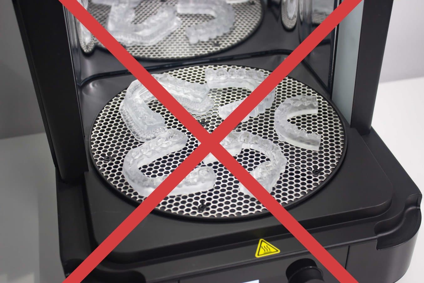

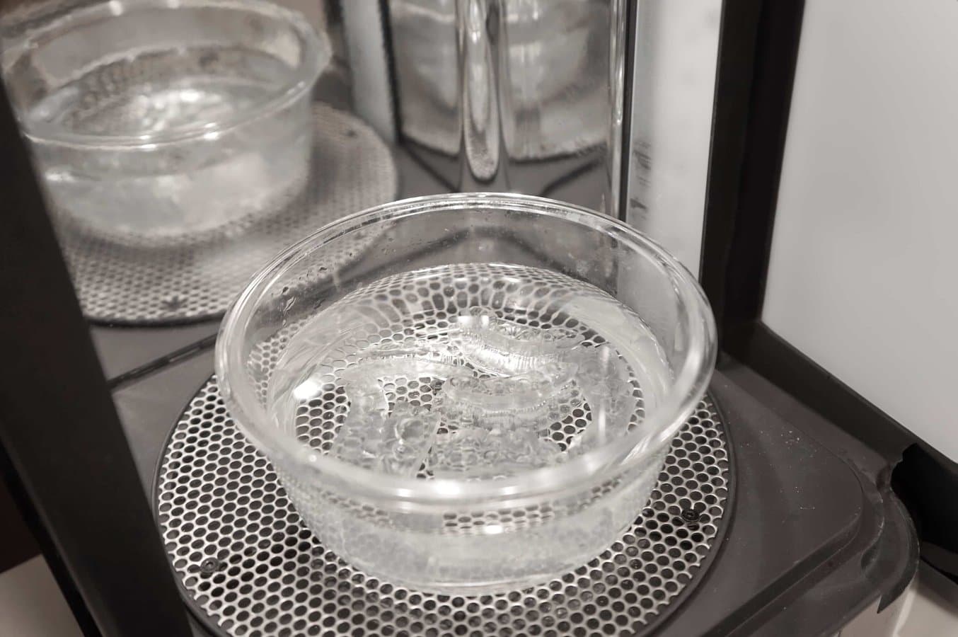

To maintain dimensional accuracy and biocompatibility, specific post-curing instructions must be followed.
Printed parts should be cured while submerged in a transparent, water-filled container inside a Form Cure using the settings established in the Manufacturing Guide.
If indirect bonding trays are printed with rafts and supports, place printed parts in the Form Cure with the raft side down. If the trays are printed directly on the build platform without supporting structures, place the part in the Form Cure with the intaglio surface of the appliance facing up.
Printed parts submerged in a transparent, water-filled container

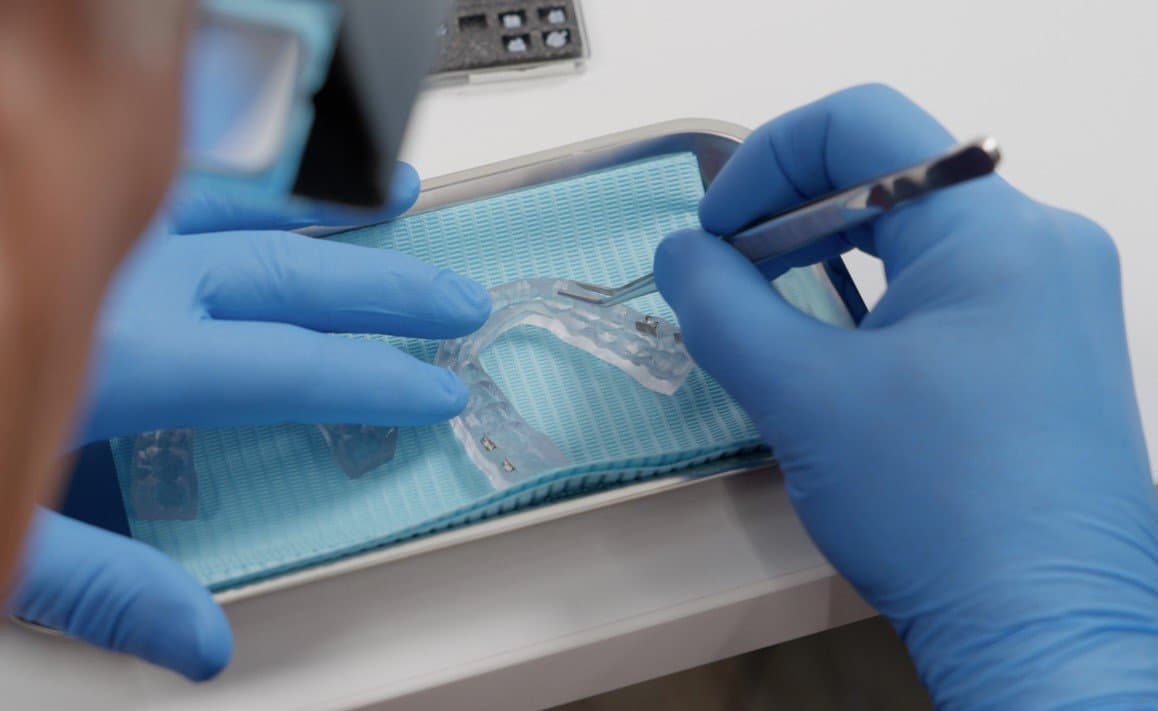

5.5 Support Removal
If supports were used, remove the supports using the clippers provided in the Formlabs Finish Kit, or scissors.
IBT support removal
5.6 Finishing
After support removal, if any support structures are left on the surface of the 3D printed indirect bonding tray, you can remove them with a set of sharp Iris scissors.
Inspect the appliance. Discard and reprint it if any damage or cracks are detected.
finishing dental part

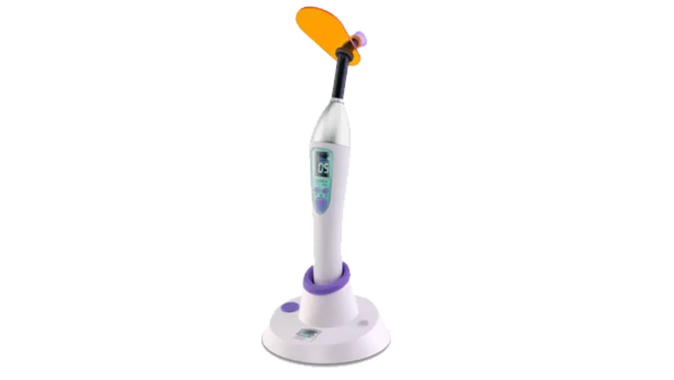

6.1 UV Cure Light Recommendation
While working with orthodontists, we found having the right UV curing light greatly improves the adhesion of the brackets through the indirect bonding tray. A fairly affordable, high-powered light we recommend is the Ledex WL-090+ Curing Light.
UV Cure Light
