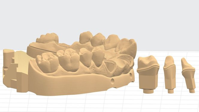

3.3 Orient parts (supports optional)
Print parts directly on the build platform to decrease print time and save resin. Both hollow and solid models can be printed directly on the built platform. To snap the flat bases to the build platform, use the “Select Base” feature under the Orientation menu.

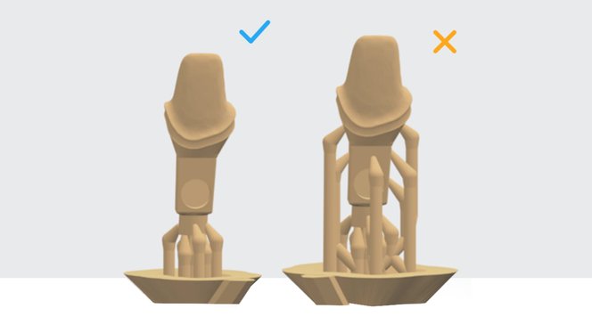

Printing on supports is also possible, and is recommended in cases where dies have small pin diameters (less than 3 mm).
If printing with supports, ensure that:
1. Supports only touch the base pins on the dies
2. Supports do not touch the inside of the die sockets on the arches

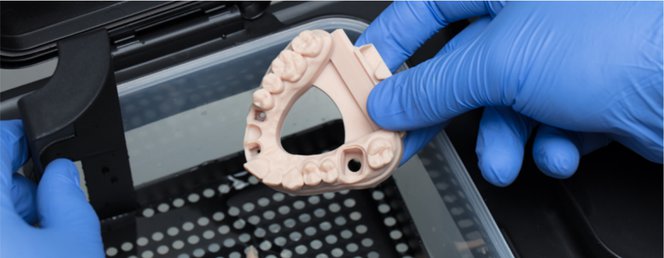

4.2 Wash the printed parts
Rinse parts in isopropyl alcohol (IPA, 90% or higher; 99% recommended) until uncured resin is fully cleaned from the parts. For best results, use two Form Wash units, with one initial wash for 10 minutes, and a subsequent 5 minute wash in cleaner IPA. Alternately, use one Form Wash for 15-20 minutes and quickly rinse parts in clean IPA for 2 minutes afterwards. When using the manual Finish Fit, rinse parts consecutively in two buckets of IPA for 10 minutes each.
Leave parts to air dry completely, or use a compressed air hose to blow IPA off of the parts. Inspect closely to ensure all uncured resin has been removed from the parts.

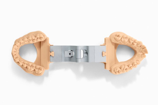

4.5 Assemble to Finish
Finally, assemble the dies into the models to complete the case.
